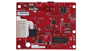

  • Hello Kaushik,
    Please note:
    The board we are using is AWR1843BOOST EVM
    Observation with the board is same as explained in above chats by my team mate Ayush.
