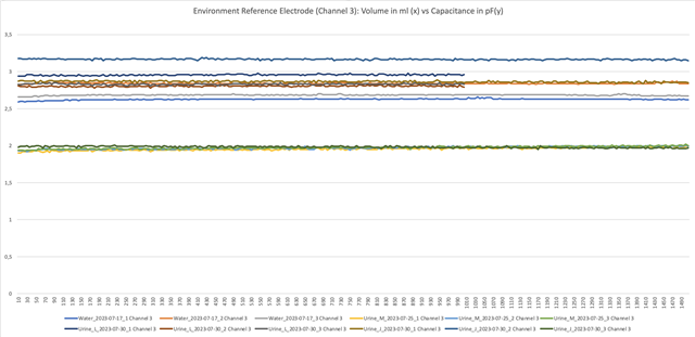

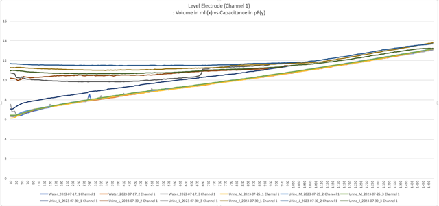

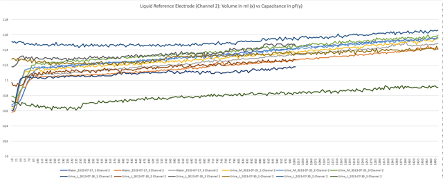

  • What we are seeing here are liquid(x) vs capacitance(volume) graphs of the level electrode with 4 different samples (1x water, 3x urine) while each sample was tested 3 times in a row. So we are seeing 4 x 3 = 12 curves. The first two samples (water, first urine sample) showed normal system behaviour, the 6 curves are closely together. Afterwards the error occurred. The 6 curves of the other 2 urine samples are shifted towards a higher capacitance level and differ within the same sample as well as between the two samples.
  • The problem can clearly be seen in the the environment reference electrode'S liquid(x) vs capacitance (y) graph. While the values of the electrode during normal operation remain unchanged (lower 6 curves at 2pf) they start to change there level when the error occurs (upper 6 curves)
  • It seems to me that the we are dealing with randomly changing baseline values (when the container is empty) across all electrodes while the system is approaching a similar target capacitance levels when the container is filled (as can be seen by converging lines of the level electrodes). Could it be that we have a software bug related to this setting?

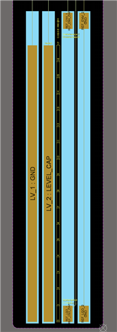

    • Sensor layout posted below (based on reference design but with wire terminal moved from bottom to top)

    Your measurement configurations are that of using the out of phase technique but the layout says GND. Are the GND labels in the layout actually connected to GND or Shield 2 of the FDC1004? I wouldn't expect this to cause the issue you are seeing, but having the connections to shield instead of GND will help ensure better performance against noise and external impacts.

    the GND labels in the layout are connected to Shield 2 as you suggested and as defined in the application note. Shielding and OoP seems to work well: When touching the backside of the PCB it will not influence the measurement at all. Presence of hands or other external factors also don't seem to influence the measurements easily. Regarding your questions:
