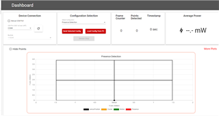

For context, I am currently trying to run the Presence and Motion demo on the industrial visualizer. I've flashed the appimage onto the EVM using Uniflash, and I selected the presencedetect.cfg file for the config file. However, the console continues to flash the following error when I try and start the visualizer.
ERROR: No data detected on COM Port, read timed out
Be sure that the device is in the proper mode, and that the cfg you are sending is valid
I'm not really sure as to why I keep getting this error. The EVM should be in the right mode, and I'm using a given config file. I'm also using the right COM port. I'd appreciate any answers/help anyone may have.

  • Hey Tim,
    I should be using the correct COM ports, and I've added the screenshots to this reply. I also have he IWRL6432 and Out of box demo selected in the GUI.
    I tried those 3 suggestions, and I've still had no luck. I'm still getting the error on the industrial visualizer, and the SDK visualizer never starts after sending the config. It looks like it just froze. I've also attached a screenshot of what it looks like.

  • Hi Ben,
    Does the terminal for the SDK visualizer say anything specific or throw any errors after you send a configuration file?

  • Hey Tim,
    I'm not seeing any errors after the commands sent using the config file. Here are the pictures of the EVM and the IWRL6432 chip.
