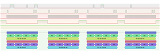

    The device is now in stand-by mode. As you can see I also enabled CRC calculations. Regarding your second question, no, I did not check it with an oscilloscope yet, however please look below. This is the frame that is intended to trigger the conversion:
    As you can see, at the end of this frame there is CRC. The next read request has got the first byte equal to 0x40, which means most significant bit is not set and thus PREV_CRC_STAT is not present, which means CRC for the trigger frame was correct. If there was some noise on the bus, I think the CRC would be wrong (of course, there is a low probability that both, data bits and crc were distorted and then thanks to some luck the CRC is correct even for wrong data, but I also tried to trigger the conversion by reading & writing to other registers, TMAG never returned CRC error for any of those operations)
  • Hey Michals,
    Could you try increasing your hold time? The time between the last SCK falling edge and the CS rising edge looks rather short, perhaps there is some internal logic not getting latched before your CS goes high.
  • Hey Patrick,
    thanks for help. I can confirm, after I increased the hold time to 100us, the conversion is now properly triggered.
