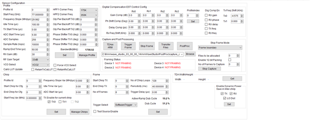

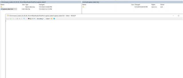

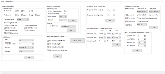

I am currently running into some issues with getting raw data from mmWave Studio 3.0.0.14 I am following the Cascade User guide and have been able to connect to AWR2243 Four-Device Cascade Radar. However every time I try to collect raw data my bin files are empty. I do get a .fig file which I am able to open in matlab but not the bin file.
I have successfully used the IWR6843AOP board with the DCA100 board in the past. I followed the same API for DataConfig. The only changes I made were for Frame config. I left defaults in most situations.
I have attached a few pictures describing my setup. I would greatly appreciate some help thank you.
Thank you,
Diana
Empty Binary File
  • Dear Diana -
    Thanks for the post and welcome to E2E!

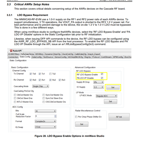

    I noticed that you did not have these two boxes ticked in your setup.

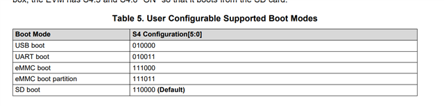

    This is from the EVM user guide, page 39 ==> https://www.ti.com/lit/ug/swru553a/swru553a.pdf
    Then, if possible, would you please go through section 7 (starts page 10) and on to double check the steps you have taken?
    https://software-dl.ti.com/ra-processors/esd/MMWAVE-STUDIO/latest/exports/mmwave_studio_cascade_user_guide.pdf

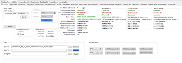

  • Hi Josh thank you for taking the time to respond. I still get empty bin file. I have revised the steps taken from chapter 7 of the User Guide and modified my Static configuration tab. I can see that the LogFile is updated every time I try to connect data but the .bin file is still empty. Do you have any suggestions?
  • Is it possible for you to share a picture of your connections?
    -E. Shareef
  • Hi
    I have attached two images. I am following the setup described in "mmWave Studio Cascade" .Thank you for taking the time to respond I look forward to hearing from you.
    -Diana

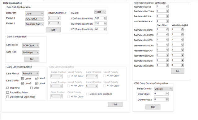

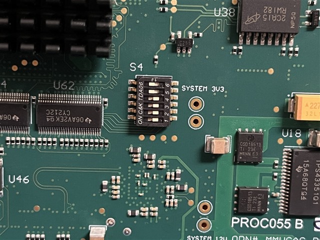

  • Is this a DCA1000 you are using for capture? If so, can you share the switch settings?
    -E. Shareef
    Which version of mmWave Studio and DFP are you using?
    Can you try running the Cascade example scripts located at C:\ti\mmwave_studio_03_00_00_14\mmWaveStudio\Scripts\Cascade?
    First, you need to run the Cascade_Configuration_Basic.lua to configure the radar. Then, you can run the Cascade_Capture.lua.
    If this still does not work, please share the full mmWave Studio log for the running of the above scripts.

    I am Diana's collegue.
    We are using: mmwave_studio_03_00_00_14 and mmwave_dfp_02_02_04_00.
    We just tried running the two scripts, and the problems occurs with the script Cascade_Capture.lua. Please note that in the script Cascade_Configuration_Basic.lua we changed:
    metaImagePath            =   "C:\\ti\\mmwave_dfp_02_02_02_01\\firmware\\xwr22xx_metaImage.bin"
    to
    metaImagePath            =   "C:\\ti\\mmwave_dfp_02_02_04_00\\firmware\\xwr22xx_metaImage.bin"
    and it executed successfully.
    Logs are attached.
    Ivo

    [12:20:02]  [RadarAPI]: ar1.RfInit_mult(2)
    [12:20:03]  [DeviceId-1] RF Init async event received!
    [12:20:03]  [RadarAPI]: Time stamp, Temperture: 2409,37; APLL Status, Update: 1, 0; SynthVCO1 Status, Update: 1, 1; SynthVCO2 Status, Update: 1, 1; LODist Status, Update: 1, 1; RxADCDC Status, Update: 1, 1; HPFcutoff Status, Update: 1, 1; LPFcutoff Status, Update: 1, 1; PeakDetector Status, Update: 1, 1; TxPower Status, Update: 1, 1; RxGain Status, Update: 1, 1; TxPhase Status, Update: 1, 1; RxIQMM Status, Update: 1, 1;
    [12:20:03]  [RadarAPI]: Status: Passed
    [12:20:03]  Device 2 : RF Init Successful
    [12:20:03]  AWR Device2 Configuration Successful!
    [12:20:03]  Device3 Configuration Started...
    [12:20:03]  [RadarAPI]: Device 4 : CAPTURE_RESPONSE_ACK Async event recieved() with status 0
    [12:20:04]  [RadarAPI]: ar1.FullReset(4)
    [12:20:04]  [RadarAPI]: Status: Passed
    [12:20:04]  [RadarAPI]: ar1.SOPControl_mult(4,4)
    [12:20:04]  Device 3 : SOP Reset Successful
    [12:20:04]  [DeviceId-2] MSS power up done async event received!
    [12:20:04]  [RadarAPI]: ar1.AddDevice(4)
    [12:20:04]  Device 3 : SPI Connection Successful
    [12:20:04]  [RadarAPI]: ar1.DownloadBssFwOvSPI_mult(4, C:\\ti\\mmwave_dfp_02_02_04_00\\firmware\\xwr22xx_metaImage.bin)
    [12:20:07]  Device 3 : FW Download Successful
    [12:20:08]  [RadarAPI]: ar1.SelectChipVersion("AR1243")
    [12:20:08]  [RadarAPI]: Status: Passed
    [12:20:08]  [RadarAPI]: ar1.SelectChipVersion("XWR2243")
    [12:20:08]  Slave2 Device Status : XWR2243/ASIL-B/SOP:4/ES:1.1
    [12:20:08]  [RadarAPI]: ar1.RfEnable_mult(4)
    [12:20:08]  [DeviceId-2] BSS power up done async event received!
    [12:20:09]  [RadarAPI]: Status: Passed
    [12:20:10]  Device 3 : RF Power Up Successful
    [12:20:10]  [RadarAPI]: ar1.ChanNAdcConfig_mult(4, 1, 1, 1, 1, 1, 1, 1, 2, 1, 0, 2)
    [12:20:10]  [RadarAPI]: Status: Passed
    [12:20:10]  Device 3 : Channel & ADC Configuration Successful
    [12:20:10]  [RadarAPI]: ar1.RfLdoBypassConfig_mult(4, 0x4)
    [12:20:10]  Device 3 : LDO Bypass Successful
    [12:20:10]  [RadarAPI]: ar1.LPModConfig_mult(4, 0,0)
    [12:20:10]  Device 3 : Low Power Mode Configuration Successful
    [12:20:10]  [RadarAPI]: ar1.SetMiscConfig_mult(4, 1, 0, 0, 0)
    [12:20:11]  [RadarAPI]: Status: Passed
    [12:20:11]  Device 3 : Misc Control Configuration Successful
    [12:20:11]  [RadarAPI]: ar1.RfInitCalibConfig_mult(4, 1, 1, 1, 1, 1, 1, 1, 65537)
    [12:20:11]  Device 3 : RF Init Calibration Successful
    [12:20:11]  [RadarAPI]: ar1.RfInit_mult(4)
    [12:20:11]  [DeviceId-2] RF Init async event received!
    [12:20:11]  [RadarAPI]: Time stamp, Temperture: 2330,38; APLL Status, Update: 1, 0; SynthVCO1 Status, Update: 1, 1; SynthVCO2 Status, Update: 1, 1; LODist Status, Update: 1, 1; RxADCDC Status, Update: 1, 1; HPFcutoff Status, Update: 1, 1; LPFcutoff Status, Update: 1, 1; PeakDetector Status, Update: 1, 1; TxPower Status, Update: 1, 1; RxGain Status, Update: 1, 1; TxPhase Status, Update: 1, 1; RxIQMM Status, Update: 1, 1;
    [12:20:11]  Device 3 : RF Init Successful
    [12:20:12]  AWR Device3 Configuration Successful!
    [12:20:12]  Device4 Configuration Started...
    [12:20:12]  [RadarAPI]: Device 8 : CAPTURE_RESPONSE_ACK Async event recieved() with status 0
    [12:20:12]  [RadarAPI]: ar1.FullReset(8)
    [12:20:12]  [RadarAPI]: Status: Passed
    [12:20:12]  [RadarAPI]: ar1.SOPControl_mult(8,4)
    [12:20:12]  Device 4 : SOP Reset Successful
    [12:20:12]  [DeviceId-3] MSS power up done async event received!
    [12:20:13]  [RadarAPI]: ar1.AddDevice(8)
    [12:20:13]  [RadarAPI]: Status: Passed
    [12:20:13]  Device 4 : SPI Connection Successful
    [12:20:13]  [RadarAPI]: ar1.DownloadBssFwOvSPI_mult(8, C:\\ti\\mmwave_dfp_02_02_04_00\\firmware\\xwr22xx_metaImage.bin)
    [12:20:16]  Device 4 : FW Download Successful
    [12:20:16]  [RadarAPI]: ar1.SelectChipVersion("AR1243")
    [12:20:16]  [RadarAPI]: Status: Passed
    [12:20:16]  [RadarAPI]: ar1.SelectChipVersion("XWR2243")
    [12:20:17]  Slave3 Device Status : XWR2243/ASIL-B/SOP:4/ES:1.1
    [12:20:17]  [RadarAPI]: ar1.RfEnable_mult(8)
    [12:20:17]  [DeviceId-3] BSS power up done async event received!
    [12:20:17]  [RadarAPI]: Status: Passed
    [12:20:18]  Device 4 : RF Power Up Successful
    [12:20:18]  [RadarAPI]: ar1.ChanNAdcConfig_mult(8, 1, 1, 1, 1, 1, 1, 1, 2, 1, 0, 2)
    [12:20:19]  [RadarAPI]: Status: Passed
    [12:20:19]  Device 4 : Channel & ADC Configuration Successful
    [12:20:19]  [RadarAPI]: ar1.RfLdoBypassConfig_mult(8, 0x8)
    [12:20:19]  Device 4 : LDO Bypass Successful
    [12:20:19]  [RadarAPI]: ar1.LPModConfig_mult(8, 0,0)
    [12:20:19]  Device 4 : Low Power Mode Configuration Successful
    [12:20:19]  [RadarAPI]: ar1.SetMiscConfig_mult(8, 1, 0, 0, 0)
    [12:20:19]  Device 4 : Misc Control Configuration Successful
    [12:20:19]  [RadarAPI]: ar1.RfInitCalibConfig_mult(8, 1, 1, 1, 1, 1, 1, 1, 65537)
    [12:20:19]  Device 4 : RF Init Calibration Successful
    [12:20:19]  [RadarAPI]: ar1.RfInit_mult(8)
    [12:20:19]  [DeviceId-3] RF Init async event received!
    [12:20:19]  [RadarAPI]: Time stamp, Temperture: 2503,39; APLL Status, Update: 1, 0; SynthVCO1 Status, Update: 1, 1; SynthVCO2 Status, Update: 1, 1; LODist Status, Update: 1, 1; RxADCDC Status, Update: 1, 1; HPFcutoff Status, Update: 1, 1; LPFcutoff Status, Update: 1, 1; PeakDetector Status, Update: 1, 1; TxPower Status, Update: 1, 1; RxGain Status, Update: 1, 1; TxPhase Status, Update: 1, 1; RxIQMM Status, Update: 1, 1;
    [12:20:19]  Device 4 : RF Init Successful
    [12:20:20]  AWR Device4 Configuration Successful!
    [12:20:20]  Device1 Configuration Started...
    [12:20:20]  [RadarAPI]: ar1.DataPathConfig_mult(1, 0, 1, 0)
    [12:20:20]  [RadarAPI]: Status: Passed
    [12:20:20]  Device 1 : Data Path Configuration Successful
    [12:20:20]  [RadarAPI]: ar1.LvdsClkConfig_mult(1, 1,1)
    [12:20:20]  Device 1 : Clock Configuration Successful
    [12:20:20]  [RadarAPI]: ar1.CSI2LaneConfig_mult(1, 1, 0, 2, 0, 4, 0, 5,0,3,0, 0)
    [12:20:20]  Device 1 : CSI2 Configuration Successful
    [12:20:21]  AWR Device1 Configuration Successful!
    [12:20:21]  Device2 Configuration Started...
    [12:20:21]  [RadarAPI]: ar1.DataPathConfig_mult(2, 0, 1, 0)
    [12:20:21]  [RadarAPI]: Status: Passed
    [12:20:21]  Device 2 : Data Path Configuration Successful
    [12:20:21]  [RadarAPI]: ar1.LvdsClkConfig_mult(2, 1,1)
    [12:20:21]  Device 2 : Clock Configuration Successful
    [12:20:21]  [RadarAPI]: ar1.CSI2LaneConfig_mult(2, 1, 0, 2, 0, 4, 0, 5,0,3,0, 0)
    [12:20:21]  Device 2 : CSI2 Configuration Successful
    [12:20:22]  AWR Device2 Configuration Successful!
    [12:20:22]  Device3 Configuration Started...
    [12:20:22]  [RadarAPI]: ar1.DataPathConfig_mult(4, 0, 1, 0)
    [12:20:22]  [RadarAPI]: Status: Passed
    [12:20:22]  Device 3 : Data Path Configuration Successful
    [12:20:22]  [RadarAPI]: ar1.LvdsClkConfig_mult(4, 1,1)
    [12:20:22]  Device 3 : Clock Configuration Successful
    [12:20:22]  [RadarAPI]: ar1.CSI2LaneConfig_mult(4, 1, 0, 2, 0, 4, 0, 5,0,3,0, 0)
    [12:20:22]  Device 3 : CSI2 Configuration Successful
    [12:20:23]  AWR Device3 Configuration Successful!
    [12:20:23]  Device4 Configuration Started...
    [12:20:23]  [RadarAPI]: ar1.DataPathConfig_mult(8, 0, 1, 0)
    [12:20:23]  [RadarAPI]: Status: Passed
    [12:20:23]  Device 4 : Data Path Configuration Successful
    [12:20:23]  [RadarAPI]: ar1.LvdsClkConfig_mult(8, 1,1)
    [12:20:23]  Device 4 : Clock Configuration Successful
    [12:20:23]  [RadarAPI]: ar1.CSI2LaneConfig_mult(8, 1, 0, 2, 0, 4, 0, 5,0,3,0, 0)
    [12:20:23]  Device 4 : CSI2 Configuration Successful
    [12:20:24]  AWR Device4 Configuration Successful!
    [12:20:24]
    [12:20:24]  ***Script completed successfully.***
    [12:20:34]  Loops Remaining : 1
    [12:20:34]  Starting TDA ARM...
    [12:20:34]  [RadarAPI]: ar1.TDACaptureCard_StartRecord_mult(1, 0, 0, Cascade_Capture_22xx, 0)
    [12:20:34]  Device 0 - Configuring TDA with Width : 0 and Height : 0
    [12:20:34]  [RadarAPI]: Device 0 - setWidthAndHeight Status: Passed
    [12:20:34]  [RadarAPI]: Device 1 : CAPTURE_RESPONSE_ACK Async event recieved() with status 0
    [12:20:34]  Device 1 - Configuring TDA with Width : 0 and Height : 0
    [12:20:34]  [RadarAPI]: Device 1 - setWidthAndHeight Status: Passed
    [12:20:34]  Device 2 - Configuring TDA with Width : 0 and Height : 0
    [12:20:34]  [RadarAPI]: Device 2 : CAPTURE_RESPONSE_ACK Async event recieved() with status 0
    [12:20:34]  [RadarAPI]: Device 2 - setWidthAndHeight Status: Passed
    [12:20:34]  [RadarAPI]: Device 4 : CAPTURE_RESPONSE_ACK Async event recieved() with status 0
    [12:20:34]  Device 3 - Configuring TDA with Width : 0 and Height : 0
    [12:20:34]  [RadarAPI]: Device 3 - setWidthAndHeight Status: Passed
    [12:20:34]  [RadarAPI]: Device 8 : CAPTURE_RESPONSE_ACK Async event recieved() with status 0
    [12:20:34]  Sending Frame Periodicity of 0 to TDA..
    [12:20:34]  [RadarAPI]: Status: Passed. Frame Periodicity sent to TDA
    [12:20:34]  [RadarAPI]: Device 32 : CAPTURE_RESPONSE_ACK Async event recieved() with status 0
    [12:20:34]  Sending Capture Directory with name /mnt/ssd/Cascade_Capture_22xx to TDA..
    [12:20:34]  [RadarAPI]: Status: Passed. Capture Directory sent to TDA
    [12:20:34]  Sending File Allocation of 0 files to TDA..
    [12:20:34]  [RadarAPI]: Status: Passed. File Allocation sent to TDA
    [12:20:34]  Sending Enable Data Packaging (0 - 16-bit; 1 - 12-bit) with value of 0 to TDA..
    [12:20:34]  [RadarAPI]: Status: Passed. Enable Data Packaging sent to TDA
    [12:20:34]  Sending Number of frames to capture with value of 0 to TDA..
    [12:20:34]  [RadarAPI]: Status: Passed. Number of frames to capture sent to TDA
    [12:20:34]  [RadarAPI]: Status: Passed for notifying TDA about Creating Application
    [12:20:44]  Create Application Response from Capture Card timed out!!
    [12:20:44]  TDA ARM Failed
    [12:20:44]
    [12:20:44]  ***Script completed successfully.***
    Sorry, looking at the logs I noticed that there is a third script that needs to be run. So, the sequence should be as follows:
    1. Cascade_Configuration_Basic.lua -> configures the sensors up to the datapath configuration
    2. Cascade_Configuration_MIMO.lua -> configures the chirp and frame settings for MIMO operation
    3. Cascade_Capture.lua -> performs that data capture
    Because you were missing #2, there was no chirp or frame configuration programmed to the sensor, so there was nothing to capture. Now, with the above three scripts hopefully it should work.
    Adrian
  • Thanks!
    Looks ok now, we get some data.
    Ivo
