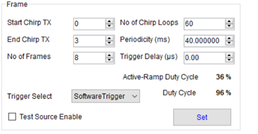

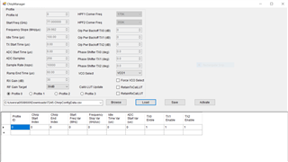

Our customer wants to use AWR2944EVM and DCA1000EVM to get ADC data with 4TX and 4RX. In particular, they want to make a MIMO measurement that switches every single Tx.

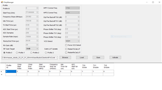

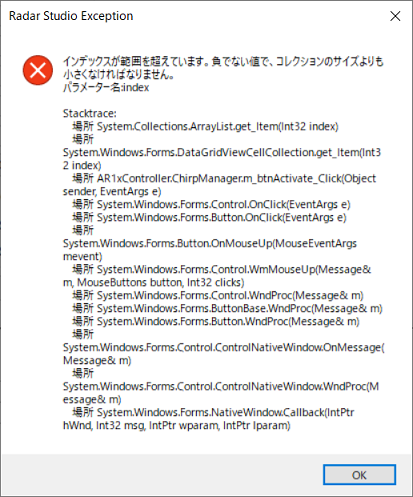

They were able to get the data using the mmWave Studio 3.1.1, but the Chirp Manager cannot be activated with an error, so they don't know if the Tx is switched.
The settings in the mmWave Studio 3.1.1 are summarized below. The default values are used for all settings except as noted.
1. The firmware is located at the following location (C:\ti\mmwave_studio_03_01_01_00\rf_eval_firmware\AWR2944_ES2)

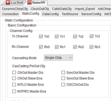

2. In the StaticConfig tab, under "Static Configuration"-"Basic Configuration"-"Channel Config", add checks for Tx2 and Tx3.
3. In the DataConfig tab, under "LVDS Lane Configuration"-"Lane Config", add a check for Lane 2.

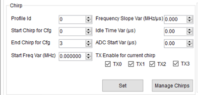

4. In the SensorConfig tab, under "Sensor Configuration"-"Chirp"-"TX Enable for current chirp", add checks for TX2 and TX3 and set "End Chirp for Cfg" to 3.
5. In the SensorConfig tab, under "Sensor Configuration"-"Frame", set "End Chirp TX" to 3 and "No of Chirp Loops" to 60.
Could you tell me the necessary settings?
Daisuke
    Add the captured Chirp Manager image.
    Daisuke

    [15:37:23]  [RadarAPI]: Frame Ended
    [15:37:25]  [RadarAPI]:
    [15:37:25]  Frame End async event received!
    [15:37:25]  Start Record command : Success
    [15:37:25]
    [15:37:25]  Record is completed
    [15:37:25]
    [15:37:25]  Record stop is done successfully
    [15:37:36]  [RadarAPI]: ar1.StartMatlabPostProc("C:\\ti\\mmwave_studio_03_01_01_00\\mmWaveStudio\\PostProc\\adc_data.bin")
    [15:37:36]  [RadarAPI]: No of files Captured: 1, Total no of frames for each device : 8
    [15:42:48]  Provide the path and filename for the Export of Capture Setup JSON configuration.
    [15:42:53]  Provide the path and filename for the Export of mmWave JSON configuration.
    [15:42:56]  Export Operation was successful!
    [16:20:30]  [RadarAPI]: ar1.ChirpConfig(3, 3, 0, 0, 0, 0, 0, 0, 0, 0, 0)
    [16:20:31]  [RadarAPI]: Status: Passed
    [16:20:58]  [RadarAPI]: ar1.CaptureCard_DisConnect()
    [16:20:58]  [RadarAPI]: Status:Passed
    [16:20:59]  [RadarAPI]: ar1.CaptureCardConfig_EthInit("192.168.33.30", "192.168.33.180", "12:34:56:78:90:12", 4096, 4098)
    [16:20:59]  [RadarAPI]: ar1.CaptureCardConfig_Mode(1, 2, 1, 2, 3, 30)
    [16:20:59]  [RadarAPI]: ar1.CaptureCardConfig_PacketDelay(25)
    [16:20:59]  [RadarAPI]: Sending fpga command to DCA1000
    [16:21:00]  [RadarAPI]:
    [16:21:00]  FPGA Configuration command : Success
    [16:21:00]  [RadarAPI]: Sending record command to DCA1000
    [16:21:00]  Configure Record command : Success
    [16:21:00]  [RadarAPI]: ar1.GetCaptureCardFPGAVersion()
    [16:21:00]  [RadarAPI]: Sending fpga_version command to DCA1000
    [16:21:00]
    [16:21:00]  FPGA Version : 2.9 [Record]
    [16:21:00]
    [16:21:06]  [RadarAPI]: ar1.CaptureCardConfig_StartRecord("C:\\ti\\mmwave_studio_03_01_01_00\\mmWaveStudio\\PostProc\\adc_data.bin", 1)
    [16:21:06]  [RadarAPI]: Sending start_record command to DCA1000
    [16:21:09]  [RadarAPI]: ar1.StartFrame()
    [16:21:09]  [RadarAPI]: Status: Passed
    [16:21:09]  Frame start async event received!
    [16:21:10]  Frame End async event received!
    [16:21:10]  [RadarAPI]: Frame Ended
    [16:21:12]  [RadarAPI]:
    [16:21:12]  Start Record command : Success
    [16:21:12]
    [16:21:12]  Record is completed
    [16:21:12]
    [16:21:12]  Record stop is done successfully
    [16:21:14]  [RadarAPI]: ar1.StartMatlabPostProc("C:\\ti\\mmwave_studio_03_01_01_00\\mmWaveStudio\\PostProc\\adc_data.bin")
    [16:21:14]  [RadarAPI]: No of files Captured: 1, Total no of frames for each device : 8
    [16:27:22]  [RadarAPI]: ar1.Calling_ATE_DisconnectTarget()
    [16:27:22]  [RadarAPI]: ar1.SaveSettings('C:\Users\254300\AppData\Roaming\RSTD\ar1gui.ini')
    [16:27:22]  RSTD.ExitRstd()
    [16:27:22]  RSTD.SaveSettings(): Settings saved to "C:\Users\254300\AppData\Roaming\RSTD\config.xml"

    Attach the CSV file used in the Chirp Manager.
    7245.ChirpConfigData.csv
    Our customer wants to configure for TDM-MIMO with 4TX and 4RX.
    Daisuke

  • Hi Saswat-san,
    Thank you for your reply.
    I understand that the log in the output window shows to be configured for TDM-MIMO with 4TX and 4RX.
    We see the error shown in my first post when activating after loading the CSV file in Chirp Manager.
    Cannot reproduce the error?
    Daisuke

  • Hello Daisuke,
    Here are the steps I followed:
    1) First set the basic config and then click on RF power up:
    2) Then went to the chirp config manager and you can see it had a default value set:
    3) Then I loaded the file provided by you after renaming it and it loaded successfully:
    I only observed an issue if the CSV was open in some other tab and then I tried to load it in the chirp manager simultaneously or else I do not see any issue as such while loading.
    Saswat Kumar
  • Hi Saswat-san,
    Please let me confirm one point.
    Did you press "Activate" after "Load" the CSV file? Do you get no error after that?
    I do not have the board at hand so I cannot try it right away.
    Daisuke
  • Hello Daisuke-san,
    I checked with the activate it is not working.
    I checked with the team it is a known issue, please advise customer not to use this.
    There is no current timeline of this when it will be fixed.
    Saswat Kumar
