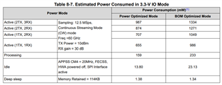

I see in the IWRL6432 datasheet there are estimated power consumed for the 3.3 V IO Mode for both the Power Optimized and the BOM Optimized Topologies:
Could you please provide some more information on the estimated power consumed for the 1.8 V IO Mode for both the Power Optimized and the BOM Optimized Topologies? Currently it seems like there is very limited power consumption related information on the 1.8 V IO Mode:
