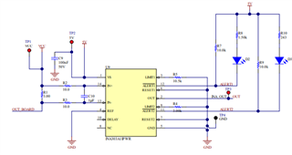

Hi Team,
Schematic references are not matching with board design what is mentioned in the document. Could you please provide the document specific to PCB?

Bhagyashree,
Can you provide specific details about what reference is not matched?
Scott
Scott,
Connector reference in schematic & PCB are not matching. Could you please share the schematic for single board (If possible please share the schematic including the output coming out from the individual board).
Bhagyashree
Bhagyashree,
The schematic and routing are available in the User's guide:
https://www.ti.com/lit/ug/slyu055a/slyu055a.pdf
I have checked both for each connector on the PCB and they appear to match. Please note that there is no electrical connection from one snap off section of the EVM to the next:
J1
J2
J3
J4
J5
J6
The output from the INA is routed to J3, which is marked "INA_OUT" on the PCB
The EVM may be used to perform standalone measurements from each section:
Or through the INA303-Q1 circuit by following the steps indicated in section 4 of the user's guide
