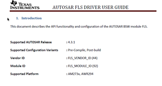

I am using the TI_FLS Driver with below info
Hi Shankar,
If you are using FLS, then in the configuration window you will see a checkbox to enable or disable memmap mode called "FlsMemMapMode".
There is no other special initialization required.
Ajay

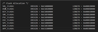

Hi Ajay,
yes you are correct HSM is using external flash and mapping is shown below
when first time I am flashing the application the HSM memory region also getting modified randomly after that it's getting stopped but seems it's corrupting something in HSM area. I am sharing both screen shot attached before application run and after application run you can observe how the HSM is getting corrupted from Address range.
Memory mapping for Flash appl
after sw flash and before application run
After application run
Hi Shankar,
I request you to keep a memory watch point for this address and run it, so when the change happens the watchpoint will be hit and code will be halted.
