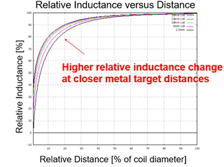

1. The relationship between coil size and test distance. The relationship between distance, coil radius and precision.

    1. The sensing distance is based on the sensor coil's outer diameter. For a larger coil size, you will be able to sense farther. Additionally, for a given coil size, you will have more resolution closer to the coil than you do farther away from it. As a general rule, we recommend keeping your target distance between 3% and 20% of the coil diameter for high resolution applications, between 20%-50% for medium resolution, and between 50% and 100% of the coil diameter for low resolution applications

  • Hello Justin,
      could you give a specific absolute accuracy for the high/medium/low resolution.
      For example, I use LDC1612 to measure the distance of an object, what are the corresponding values of these three precisions?
      looking forward to your reply.
    The exact numbers depend on the sensor coil design and device register settings. I would recommend starting with how much space is available to create a sensor coil or how much accuracy is needed in the system to help design the coil. Our LDC devices can be optimized to achieve um levels of accuracy with the right coil design/implementation but that kind of accuracy is not always required. We have our LDC calculation spreadsheet available to assist with designing a coil and generating recommended device settings for specific devices.
