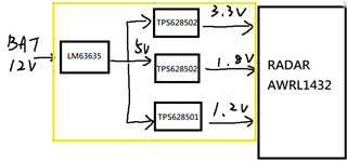

I have a question here.
at normal situation we will use two tps628502, one for 3,3Vin and another is for 1,8Vin. tps629501 for 1.2Vin as below picture.
And I notice the datasheet of AWRL1432 Noise and Ripple Specifications show at 2000kHz, 1.8V's ripple need to meet 0.153mVp-p. this is very small value for buck. so I'm confused.
then I search tps628502 datasheet show that at 2.25MHz the condition is same as normal situation. However, The Vout ripple is around 8mVp-p higher than 0.153mVp-p AWRL1432 ripple specifications.
Could you please tell me where I am misunderstanding?
