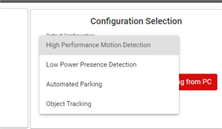

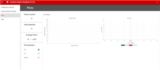

I opened the "mmWave Radar Visualizer (5.3.0)", and there tried all configurations:
I moved my hand in fron of the radar board, and faced it towards the ceiling. I barely see any noticable/consistent detections of my hand/ceiling.

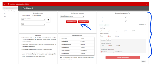

    That's an older version of the Radar toolbox that you linked to. The AWRL6432 out of box demo is now the Motion and Presence demo (linked below). Please follow up if you have questions after working through this example.
    https://dev.ti.com/tirex/content/radar_toolbox_1_20_00_11/source/ti/examples/Presence_and_Motion_Detection/docs/Presence_and_motion_users_guide.html

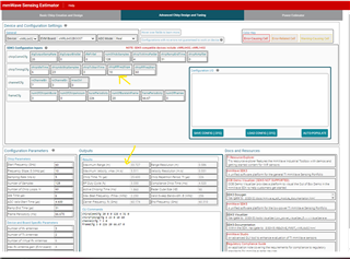

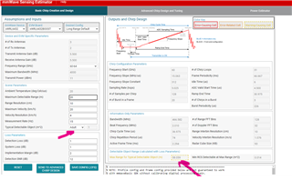

    In your sensingEstimator figure, I notice that you have a range solution of 10cm, and range FFT size of 128.  Which will only give you about 0.1*128/2 *0.85 = 5.44m of max range.   To increase to 30m, you can reduce the slope to 1/6 of your current slope, and it will increase your range resolution to 0.6m, and a maximum range of 0.6*128/2 *0.85 = 32.64m, enough to cover 30meter max range.

    2)  You can use the sensing estimator to create the configuration you need.   https://www.ti.com/mmWaveSensingEstimator
    - First, copy the configuration you have created in your original post.
    - Then go to "Advanced Chirp Design and Tuning" tab, select the right device (xWRL6432).
    - Paste the configuration you create in the first step into the "Configuration I/O" window. and click on auto-populate button.
    - Since you are happy with everything else other than the maximum range, you can modify the chirpRFFreqSlope as I mentioned in the previous reply to get until the output window shows the maximum range beyond 30m.
    Zigang

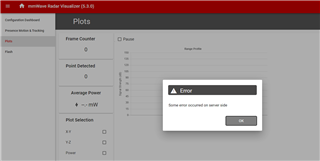

  • hi,
    1. I changed the parking_5m.cfg configuration file as you requested. now, where should I see the added rangeDoppler heatmap? is it in the visualizer? (i.e. C:\ti\MMWAVE_L_SDK_05_03_00_02\tools\visualizer\Low_power_visualizer_5.3.0.0\visualizer.exe)
    2. I used sensingEstimator and changed the chirpRFFreqSlope  value as you said:
    now I saved cfg file by pressing "SAVE CONFIG (.CFG)".
    I tried loading this cfg in visualizer, and got an error:
    what am I doing wrong?
    thanks!

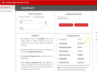

  • I modified parking_5m.cfg as you asked (see attached below)
    I flashed the device with file" the C:\ti\MMWAVE_L_SDK_05_03_00_02\examples\mmw_demo\mmwave_demo\prebuilt_binaries\xwrL64xx\mmwave_demo.release.appimage
    I loaded the configuration of parking_5m.cfg  using configuaration dashboard.
    it seems that configuration was loaded (max range increased to ~33m), but no frames are being visualized:
    also, no range-Doppler map
