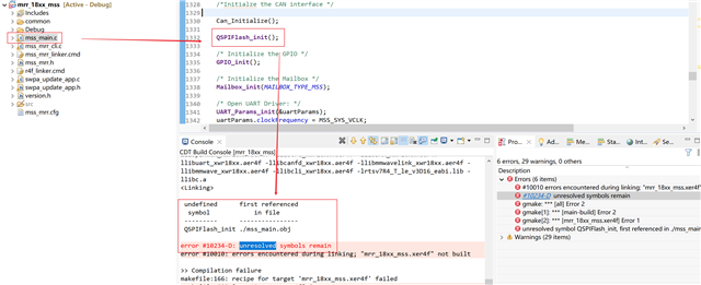

IWR1843: 基于例程medium_range_radar调用qspiflash接口在CCS下编译报错
Part Number: IWR1843

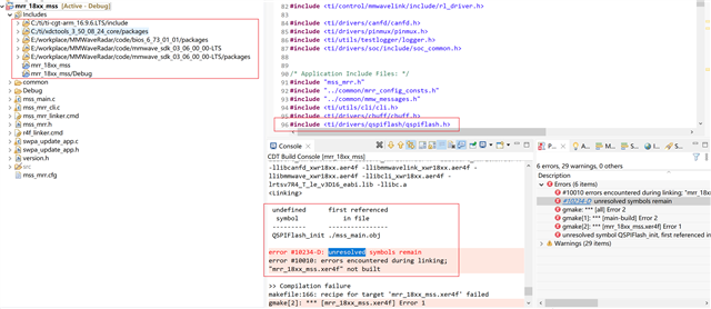

如下图所示,我是想在medium_range_radar例程下调用qspiflash接口,已经include对应的头文件了,依旧是编译报错,请问这个该怎么解决?

  • 你好,我是想在这个demo里增加SPIFALSH相关的功能,所以我加入了QSPIFlash_init()用以实现我想要的功能,加进来后我没法编译成功,请帮忙解答一下,谢谢
    Here is the translated content. Since you defined the QSPIFlash_init() function, you need to add the file where this function is defined in the CCS project
