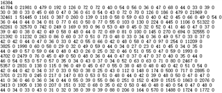

    We are trying to output a range doppler heatmap over UART with SDK 5.3, in mmwDemo_TransmitProcessedOutputTask() fuction:
    Below is part of the output data:
    The data doesn't look right. What changes should I make to get the correct data?

  • Hi Josh,
        I checked the configuration, found that the problem was "compRangeBiasAndRxChanPhase" error.
        Now the data looks right.  Thank you!
