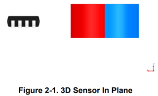

We are evaluating TMAG5273 for our application to detect the angle of a diametric ring magnet. For the given magnet/sensor orientation, would TMAG5273 be a capable sensor? Based on the Angle Measurement With Multi-Axis Linear Hall-Effect Sensors Application Note, my use-case seems similar to the In Plane scheme, with the sensor rotated 90 degrees.
  • Would the internal angle measurement work best with the YZY mag channel configuration?

    1. Yes, the internal angle measurement will work for this application. Based on your image, I you would use the XZX configuration. The pseudo simultaneous sampling can be used to equalize the noise floor when two sets of vertical sensor data are collected against one set of horizontal sensor data, as in XZX mode. It is possible that the X and Z field components measured from your spinning magnet will have unequal amplitude, so you may need to do some amplitude correction to help linearize your angle result. You can use the TI Magnetic Sense Simulator (TIMSS) to assist with magnetic simulation.

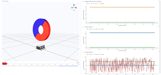

    I would like to inquire about another topic related to the TMAG5273. As you mentioned, the axes need amplitude correction for the angle computation to work properly. We captured some XYZ data in a (relatively crude) test fixture and measured these values over a 225 degree rotation sweep (blue=X, orange=Y, green=Z).
    In the device datasheet, the procedure for amplitude correction describes rotating the magnet 360 degrees and measuring the peak-to-peak amplitude of the relevant axes. However in the end-user application, the magnet will only have +/- ~45 degrees (total of 90 degrees) of rotation. Do you have any suggestions for correcting the amplitudes in this use-case?
    We could try capturing some data in a more calibrated test fixture, or using the simulator. I wasn't able to get useful data out of the simulator when simulating a 360 degree rotation.
    It would be best if we could provide our user with a way to calibrate the sensor themselves with the limited range of motion, but we realize this may not be possible. Looking forward to your response,
    Jeff
  • Hey Jeff,
    The measured data looks a little off--as if the magnet and sensor aren't very straight/the magnet isn't perpendicular to the top of the package. Better alignment should provide better data.

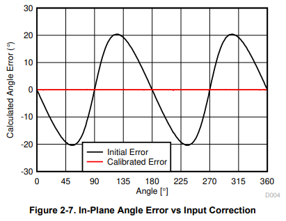

    The 360 degree rotation for the amplitude calibration is to ensure that you capture the peak to peak amplitudes of the X and Z waveforms. The peak to peak amplitude difference should cause an angle error similar to Figure 2-7 below. If your magnet is centered at a 0 crossing (ex. 90 or 180 degrees in the graph below), meaning one of the magnet's poles is aimed directly at the sensor, then rotating +/- 45 degrees would give relatively linear angle error. Otherwise the angle error would be less linear. This app note provides more details on different angle error sources and a lookup table calibration method for linearizing the angle error in section 6.

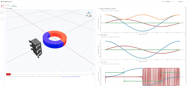

    There are some bug fixes for the simulator (TIMSS) that are in the process of being resolved--I believe the bug you are seeing is due to the rotation of the magnet. Try leaving the magnet origin positions set to 0, and move the sensor instead. I've attached a json file that I believe matches your setup--simply import it by clicking "Import design file" on the TIMSS home screen. You can tweak the sensor position and magnet dimensions/properties as needed.
      "design_name": "TMAG5273_ring",
      "magnet_id": 4,
      "poles": 2,
      "material_id": 1,
      "grade_id": 1,
      "select_remanence": "br_average",
      "remanence": 1200,
      "temperature": 20,
      "temperature_coefficient": -0.12,
      "coercivity": 12,
      "function_id": 4,
      "magnet_geometry": {
        "outer_diameter": 5,
        "inner_diameter": 3,
        "height": 1
      "magnet_position": {
        "x_position": 0,
        "y_position": 0,
        "z_position": 0
      "magnet_angle": {
        "x_angle": 0,
        "y_angle": 0,
        "z_angle": 0
      "magnet_movement": {
        "arc_length": 360
      "sim_setting": {
        "angular_step_size": 0.5
      "custom_inputs": {
        "variant": "A1",
        "package": "SOT23-6",
        "applied_vcc": 3.3,
        "maximum_input": 40,
        "temperature_compensation": 0,
        "averaging": 1,
        "bop": "bop_typ",
        "brp": "brp_typ"
      "sensor_position": {
        "x_position": 0,
        "y_position": -5,
        "z_position": 0
      "sensor_angle": {
        "x_angle": -90,
        "y_angle": 0,
        "z_angle": 0
      "user_design": 1403,
      "sensor_id": "TMAG5273"
    Hope this helps--let me know if you have additional questions.
