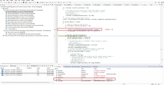

I encountered a problem while debugging using our board: an error was reported when initializing Mmwavelink, and the return value when calling the function rlDeviceGetVersion was -8. Further investigation revealed that there was no response when calling the function rlDriverWaitForResponse (refer to Attachment 1). How can I locate and solve this problem?
Additional note: The version of AWR2944 we are using should be ES1.0, and the software running SDK 4.2.0.1 can run normally.
