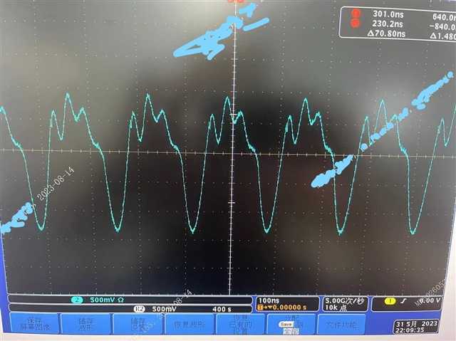

I would like to ask if the input waveform of the FDC2112 is such a signal and its positive and negative half cycle are asymmetrical, would it affect the output of the FDC2112? ,you can see it in this picture.

    The sensor signal should resemble a half-wave rectified sinusoid with the minimum level being just above ground and the peak being within the range 1.2V < Vpeak < 1.8V as suggested in the data sheet.
     It looks like your waveform has > 2Vp of swing, so it might be worth reducing the IDRIVE for that channel to see if it reduces the peak voltage.

  • Hi John,
    I got it, but i want to ask a new question about the input is an asymtemetric  signal ,the negative half wave is  not as the as the positive half. does it matter in diff input mode? will it affect the measure result?
  • Eric,
    The asymmetrical shape may indeed affect the results, particularly since the upper half of the waveform appears to have a different duration than the bottom half of the waveform.
    But before we take that much further, can you probe the two pins single-separately - showing the ground references -  and post the waveforms to this thread?

    the second is the input signal just like the upload picture before. that is the actual signal they tested, for the input signal ,we can see the up half wave has some spurs, but if they  increase  the input signal's amplitude to 2 voltage even more, the output keep stable, but if they change the input signal's amplitude to 1.2v-1.8v,the output will jump random. so we guess that when the input signal amplitude large enough ,it will beyond the acquisition zone(1.2V-1.8V),and  the original signals will be sampled in the  fixed point as the normal signal just refer the picture 2

  • Eric,
    Thank you for the additional information.
    The FDC2112 is counting axis crossings of a sensor signal that should look like a sinusoid when measured differentially across the input pins.
    The axis crossings of the differential sensor signal are counted during an interval specified by the number of axis crossings of the reference clock as specified by RCOUNTx. As your diagrams show, the customer's sensor signal looks to have a number of sinusoids in it, and this is probably messing up the axis crossing counts.

  • Hi John,
    In the actual use process, the baseline of the signal is below 0V, -0.2V or so, they have tested, it is indeed due to waveform distortion caused by the measurement results are wrong. The measurement waveform distortion is caused by the addition of EMI filtering to the signal input, remove the EMI filter circuit, the input signal is a perfect sine wave, and the test result is correct. Secondly, I want to understand the specific method of signal crossing the axis, is it like I described? If so, how to quantify the exact location of the intersection. Second, customers can ensure stable output by increasing the amplitude of the input signal. The customer wants to know where the specific internal crossover occurs, and whether it can ensure stability if the signal amplitude exceeds (1.2V-1.8V) and works for a long time.

  • Eric,
    The device looks at the differential input waveform as it crosses thru GND.
    So GND is the crossover.
    The amplitude range is specified so as to make sure the SNR is high enough to give reliable detection.
    John

  • Eric,
    A higher voltage will not damage the chip.
    The most likely complication is the waveform may clip and that could reduce the device's accuracy.
    John
