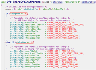

    I am using the MMW demo in SDK 5.3, and I want to use the velocity disambiguate algorithm in the SRR demo, which requires configuring two different chirps.
    I checked the code in the SDK (common_full.c), which limits the number of profiles and chirps to only 1, which means I can't configure another chirp for velocity disambiguate.
    Does the current SDK have a way to meet this requirement?
Thanks!

  • Hi Kevin Ortiz,
    Yes, I need to have two different chirps within the same frame.

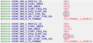

    In srr demo, we can configure two different chirps in a profile (only the idle time is different), as shown in the figure below, one of which is used for detection and the other is only used for velocity disambiguate.
    This relies on the two functions shown in the figure below:
    The implementation of the first function is shown in the figure below:
    While the configuration of the mmw demo RF front end in the 5.3 SDK uses a different process:
    Is this requirement not possible in the 5.3 SDK?
    Besides waiting for a new version of the SDK, is there any way for me to do velocity disambiguate from the point cloud layer?
    Definitely you cannot send "different profiles" within the same frame in SDK5. However, in SDK3 we often used the term "sub-frames" to describe each profile. The principle remains the same. Instead of different profiles within the same frame, we will have to use different configurations across consecutive frames.
    The implementation is of course different, but velocity disambiguate is still possible.  As I mentioned, we are working internally on supporting this and providing an example which will be available closer to the end of the year. Below are some details on the example which is a work in progress.
