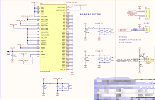

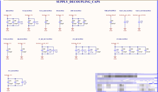

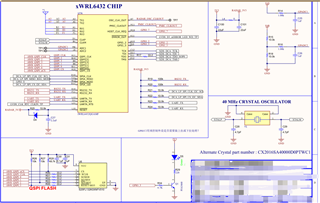

Dears,
Could you help to review the SCH, thanks!

The schematic is correct. Kindly check if the QE bit is enabled for Flash memory S25FL132K0XNFVD10, if not please enable the QE bit.
The Quad Enable (QE) bit is a nonvolatile read / write bit in the Status Register (SR2[1]) that allows Quad SPI operation.
