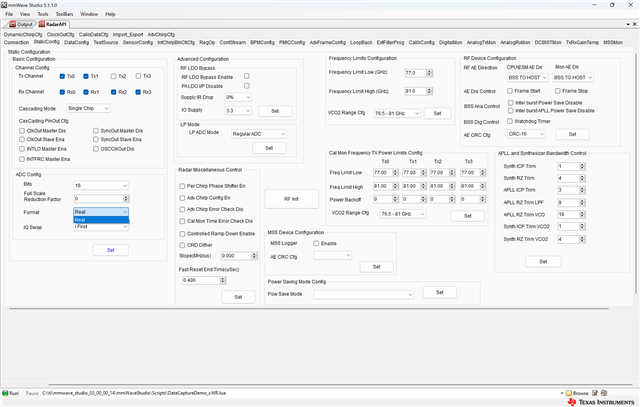

I am currently using the AWR2944EVM with DCA1000EVM. Is there any support for a complex adcFmt?

Hi Aron,
The AWR2944 only supports to real sampling.
Kaushik
