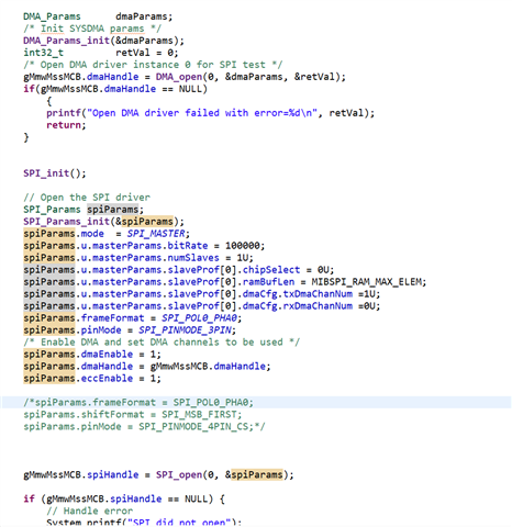

So I tried running SPI initalization is in this photo

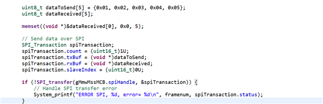

Initializatiopn passes fine. Then for test after each frame I do this:
and each time I get an error with status 6 which is SPI_TRANSFER_INVAL.
I dont know how to resolve this
Hello Ivan,
Have you first tried running the example code and checking if the example application works?
If yes, then can you modify the example application first for your need and then port the part of codes that are necessary?
