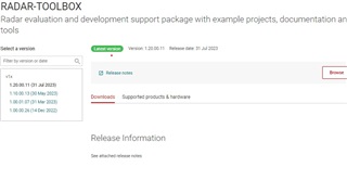

    >3. You can control the periodicity of measurement using the CFG file. You can choose the cfg file to send infinite >number of frames and also chose the frame periodicity as per your requirement]
    https://www.ti.com/tool/download/RADAR-TOOLBOX/1.20.00.11
    Below is a screen shot of that url.
    Best Regards.

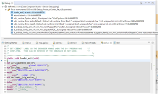

  • I don't understand what the message means when I proceed with debugging using the error information on the debugger. Please let me know if you have any advice.
    void demo_dataPathTask(UArg arg0, UArg arg1){
       demo_staticConfig();
    demo_startSensor();                                   ←(1)moved
       while(1){             ←(2)add
    demo_dataPathWait1D(dataPathObj);
    demo_findTopTanges(&chirp_data);
    SPI_transfer(spiHandle, &transaction);
    demo_config1D_HWA(dataPathObj);            ←(3)add
    demo_dataPathTrigger1D(dataPathObj);      ←(4)add
        //while(1){}             ←(5)deleate

    In the below link
    Click on Release Notes. It directs you to the tool box. Click on the download button at the top right corner to download the tool box
    You can find the cfg file at the following location in the toolbox
    radar_toolbox_1_20_00_11\source\ti\examples\Level_Sensing\high_accuracy\chirp_configs\high_accuracy_demo_14xx.cfg
    You can also refer to the project at the below location
    radar_toolbox_1_20_00_11\source\ti\examples\Level_Sensing\high_accuracy\src\14xx
    This project should allow you to control the measurement rate using the cfg
    Abhishek
