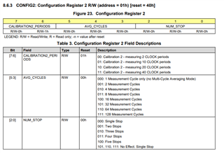

I am using the TDC7200 in combination with the TDC1000 in measurement mode 2 to do a flow measurement. I am getting a start and a stop signal, but TIME2 register stays 0. The overflow registers say, that there was no overflow. So why stays the timer zero or is it possible that the component is broken?
Best regards
Anna-Lena
  • Hello Anna-Lena,
    The TDC72000 must be configured for multiple stops if multiple stops are expected(default is 1 stop).  This is configured in configuration register 2.  TIME1 will store the measurement results from stop 1.  TIME2 will store the measurement results of the second stop, etc.
  • Hello Eddie,
    thank you for your answer! I only want to use one pulse. But i thought in measurement mode 2, I need Timer 1 and 2 to get mit TOF 1 time.
      (Datasheet page 16)
  • Never mind the problem with timer 2 is solved.

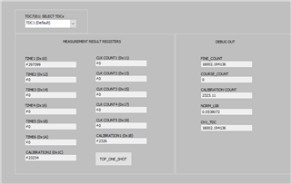

  • Thanks.  I have duplicated your configuration with the EVM.  I am able to see clockcount1=128 with 16uS timing as shown below.  It is strange that you are able to read the results registers correctly, but clockcount is not properly populated as this is not the behavior I see on the EVM.  I will consult with my colleagues and let you know any other thoughts we have.

  • Anna-Lena,
    Are you able to read back the registers to ensure you are in mode 2?  I switched to mode 1 to see if I would receive something similar to your time1 and time2 values, but it doesn't really match up.  See below for mode 1 capture.
    Also, do you have scope captures of the start and stop signals?
