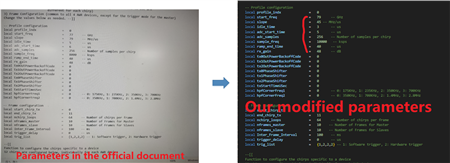

   First, since the antenna frequency point has been changed (the self-designed antenna is 79Ghz), we are not sure whether the MIMO calibration parameters given by TI officially are still applicable. Second, the calibration formula in the TI manual does not give the effect of the starting frequency point on the calibration result (as shown in Figure 1). Finally, we chose to change the starting frequency parameter in the calibration file from 77 Ghz to 79 Ghz.  Consequently, due to the bandwidth limitation, the other parameters were changed accordingly. The entire parameter changes are shown in Figure 2.  :
our parameters:
local profile_indx              =   0
local start_freq                =   79     -- GHz
local slope                     =   75 -- MHz/us
local idle_time                 =   3      -- us
local adc_start_time            =   5      -- us
local adc_samples               =   256    -- Number of samples per chirp
local sample_freq               =   10000   -- ksps
local ramp_end_time             =   40     -- us
local rx_gain                   =   48     -- dB
local tx0OutPowerBackoffCode    =   0
Original parameters:
local start_freq                =   77     -- GHz
local slope                     =   49 -- MHz/us
local idle_time                 =   5      -- us
local adc_start_time            =   6      -- us
local sample_freq               =   8000   -- ksps
Figure 1  the calibration formula
Figure 2   parameter changes

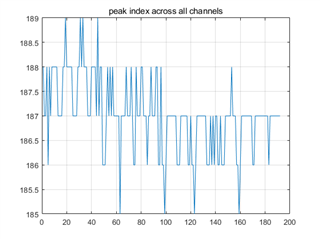

        After running the matlab program, the calibration .mat file and point indexing results were obtained (shown in Figure 3)
figure 3  point indexing results

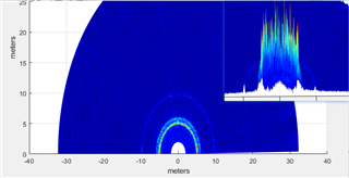

         When we applied it, we realized that the imaging results were very bad and strange:

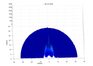

         When we use the same parameters to capture the corner reflector 5m away directly in front of the radar, we get a good RAM image as shown in Figure 4.  The peak at the target is much higher than the side flap and the peak energy is concentrated.   However, under the same conditions, when we move the corner reflector away from the center of the radar (For example,10°), the results of the RAM image are very poor, the target is barely visible and the energy is dispersed, as shown in Figure 5.    We don't understand why this is a problem.
figure 4   corner reflector at the center
figure 5   corner reflector off-center
