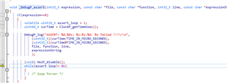

    I have tried both reset methods:
    1. Using MCU_PerformReset, I find random value in RAM after reset and the SW is in unknown place.
    2. When I used these functions " SOC_rcmR5PowerOnReset(); and SOC_rcmR5TriggerReset(); " to trigger a reset as suggested in the threads but the issue is I am stuck in SBL in issue in relevant to clock. Please check below error and call stack hierarchy.
    To explain my setup, We have SBL initially then followed by application binary which is using AUTOSAR TI MCAL. In application we have some clock initialization where parameter McuInitClock is enabled and parameter McuNoPll is enabled.
    So there is no PLL initialization done in MCAL but still MCU module is doing some initialization.
    The issue now is that SBL rechecks this and assert the SW. Could you please check what could be wrong here?

    I did exactly what you asked to integrate everything to the latest which took considerable amount of time but it didn't work out.
    Now after some analysis in Bootloader_socConfigurePll function
    First time after PoR, your code is doing the following
    1. R5 frequency is being set to 400 Mhz which Efuse Boot Frequency.
    2. Change R5 CLK source to XTAL.
    3. Initialize ADPLL.
    4. Change R5 CLK source to DPLL
    5. Set R5 frequency to 300MHz
    SOC_rcmGetEfuseBootFrequency(&bootFreqEfuseCfg);
    SOC_rcmSetR5Clock(bootFreqEfuseCfg.r5FreqHz, bootFreqEfuseCfg.sysClkFreqHz);
    Second time after Reset using the suggested APIs.
    1. SW tries to set the frequency again to 400MHz but you have a check inside SOC_rcmGetModuleClkDivVal API that inFreq%outFreq==0
    This check passes after PoR because the frequencies are according to EFUSE boot frequency, and the expected frequency is indeed 400MHz but it fails after SW reset because after all PLL initialization from first initialization the frequency is 300MHz.
    What is the best way to solve this?

  • Initially, I had same issues with EVM regarding reset.all my previous comments and screenshots are from EVM.
    But now I'm working with custom board and I see also same issue with reset.
    MCAL is configured not to touch PLL. So it's only SDK.
    In custom board the EFUSE returns 400 MHZ. Didn't Check that in EVM but I expect it's the same value because I had same symptom.
    Please check my previous screenshots
