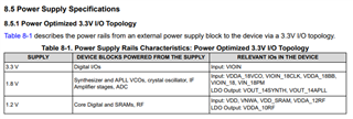

If I recall correctly, the IWRL6432Boost uses the power optimized 3.3 V IO topology:
where VION = 3.3 V.

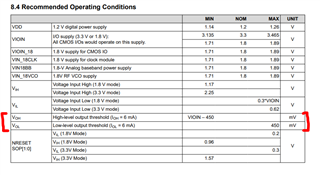

In the datasheet I see the High Level output threshold is VION - 450 mV.
So just to make sure I understand correctly, if we decided to change to the 1.8 V IO topology (where VION = 1.8V), do we expect the RDIF interface to have a High Level output threshold to be 1.35 V?

1. Do we expect the RDIF interface to have a High Level output threshold to be 1.35 V if we operate with the 1.8 V IO Topology?

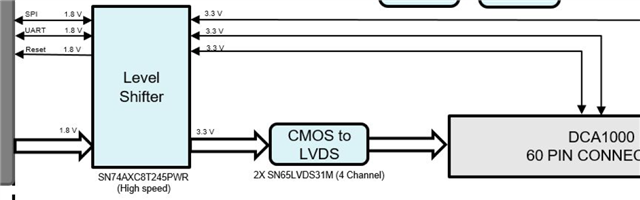

    There doesn't seem to be any LVDS drivers that operate at 1.8 V, so it seems like the RDIF interface needs to be level shifted?
    Could you please confirm whether you spot any issues with any of the level shifters below? We plan to use these level shifters with the SN65LVDS31MDREP LVDS driver.

    All the level shifters look fine. You can also use SN74AXC8T245PWR (High Speed 8bit) with SN65LVDS31MDREP LVDS driver. Below design uses SN74AXC8T245PWR High speed level shifter.
