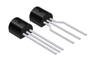

Could anyone kindly help me know the difference between LM61CIZ/NOPB, LM61CIZ/LFT2 and LM61CIZ/NOPB, thanks.

    LM61CIZ/J7000550, LM61CIZ/LFT2, LM61CIZ/NOPB.

    Please refer to the following application report for more information.The difference is in the packing options which impacts the shape of the leads and order quantity:
    • NOPB is the standard bulk packing -> devices are packed in bulk with straight leads. 1800 units per box.
    • LFT2 is a tape and reel packing -> devices are packed as seen below, with formed leads. 2000 units per reel.
    LM61CIZ/J7000550 is a restricted device which is not available via distribution.
