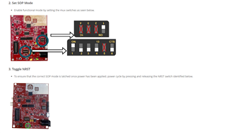

    One more doubt. Now we are running the board in the debug mode and we are only connecting USB should we need to connect 5V/3A Power also.
    And also when I don't need to run the Low Power mode visualizer and how we will know when config should be given through the UART.  Is there any message will come in the console?
    What should be the mode of the board while running the executable. ?

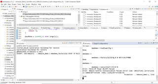

    Also still not got the idea of how to give config file through UART. While commenting the CLI_BYPASS macro the below message is coming the UART.
    [Cortex_M4_0] Calibration Validated for restore
    and it still like this for several minutes while pausing and putting the breakpoints I was able notice that it is looping around that UART_ReadPolling()

  • We were seeing this error while running mmw demo and motion detection demo in CCS.
    Sometimes we were seeing this "Error: FECSS RF Power ON/OFF failed"  "Error: mmWave Control Initialization failed [Error code -203227134] [errorLevel 2] [mmWaveErrorCode -3101] [subsysErrorCode 0]
    Exception: ../motion_detect.c, line 4040."
    Sometimes Iam facing this error
    Boot calibration error
    what might be the issue. I started with flashing only empyt release app image. later tried to run the .out files for mmwdemo and motion detection from CCS with the compiled file.

    As soon as the device is put into functional mode and powered on, it will be waiting for the configuration commands.  You won't see any output on the console.  However, once you send the configuration commands, you can see the radar output on the serial terminal.  To run the executable, you will need to switch the board into functional mode.

    Please look at section 6 in the presence and motion user guide for instructions on how to send the device configuration.
    This error can happen if the configuration being passed produces invalid values in the data-path.  Often times the best way to fix this is to step through the data-path and determine where it is failing, and often times it will indicate which configuration value was incorrect.  In addition, you may have to reset your device before restarting a debug session, as this error can pop up if not reset before the next debug session is started.

    Do you have any suggestion regarding the errors, mentioned below.
    Error: FECSS RF Power ON/OFF failed, where this is happening inside the CLI_MMWaveSensorStart and
    Error: mmWave Control Initialization failed [Error code -203327134] [errorLevel 2] inside the mmwDemo_mmWaveInit function.

    This indicates that there is something wrong with the chirp configuration that you are using, and the incorrect configuration will not allow the device to start.  Double check that your configuration is correct and valid via the sensing estimator, although this error should not occur if you use the chirp configurations provided in the SDK.

  • Sorry, I have only connected the UART now, so to communicate both the CCS and visualiser we would require JTAG connection as well?
    Can you show us how the connection should be?
  • Hello.
    As long as you have the switches for the IWR6432Boost EVM set correctly, JTAG connection should be set up correctly.  The EVM Operational Set Up Modes guide should show you what the switches should be for functional mode, which will allow you to connect to CCS while also running the visualizer.  I have included an image here for reference.
    As Josh mentioned earlier, also check to make sure that you have either lowpowercfg 0 or lowpowercfg 2, which disables and emulates low power mode, respectively.  If you are using lowpowercfg 2, this will allow you to continue running the debugger while in "low power mode".  If you have lowpowercfg 1, then your device will enter actual low power mode, which results in the debugger getting disconnected.
