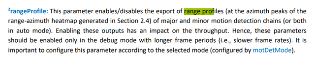

What is the difference between Range profile Major and Minor detection?
Is there any specific documentation available for the same.
Any Q format is applied for the Range profile in IWRL6432?

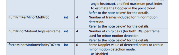

What is the bandwidth to be considered  for each major minor detection?
  • The range profile is constructed from the maximum of the angle/doppler detections for each range bin. So, the major profile will correspond to faster movements and the minor profile will correspond to slower movements.
    The docs in the SDK docs/ folder describe this.
    See the python code in the industrial visualizer for decoding the range profile packets. It appears that we simply take 20log10 of the integer value returned in the TLV.
    This depends on the time between frames. Calculate this with the 5th and 6th arguments in the sigProcChainCfg
