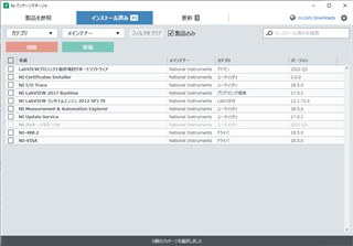

  • Hi Bob
    Thank you for response.
    I have already installed LabVIEW 2012 SP1 (32bit).
    I have tried reinstalling, but I still get the same error.
    Masahiro Morita
  • Hi Masahiro Morita,
    Thanks for the additional screen shots.  I do not have access to the lab today to troubleshoot further.  I will not be able to check until Tuesday next week earliest.  Just to verify, do you have the external 10V minimum supplied to the EVM at the banana jacks?
    Bob B

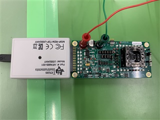

  • Hi Bob,
    I found the cause when I was checking various methods you taught me.
    The direction was revevrsed when connecting USB2ANY and EVM board.
    I reinserted it in the correct direction and I was able to communicate successfully.
    I made a silly mistake.
    Thanks for all your help.
    Masahiro Morita
    I don't have a USB2ANY in an enclosure, and it has been a long time since I have seen one in an enclosure that I didn't notice the labeling on the box indicating the direction in the picture you sent.  I'm glad you were able to figure it out.
