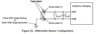

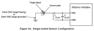

    Do your FDC2214 sensor connections resemble the first figure below, the second figure, or something else?
    What are the inductor and capacitor values you are using on your FDC2214 PCB?
    Were you able to confirm the8MHz nominal sensor frequency for the FDC2214?
    Regards.
    John
  • Hi John,
    for both FDC2214 and FDC1004 implementations we have constructed, it's like Figure 54 (single-ended sensor configuration).
    My tank components are  18uH (NLV25T-180J-EFD from TDK)   and 2.7pF  +- 0.5pF (RF15N2R7A500CT from Walsin)
