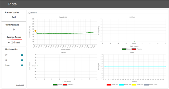

Table 1 indicates 50 mW for "3+ persons tracking".  I would like to confirm that measurement / duplicate that set-up.
I have a Boost board and ran the "human nonhuman classification" demo.  It did a nice job tracking multiple people in its FOV.  However, when I measured power consumption, I saw 1W+ going into the digital core supply.  I had noticed the errata on the power measurement function and used a 6-digit DMM to measure the voltage drop across the sense resistor directly.
