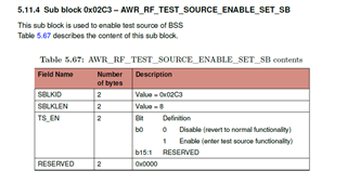

Is there any way to verify that the test source is enabled as we encountered that the ADC data captured is not correct.
  • Dear Andy -
    Thanks for the post and welcome to E2E!
    Perhaps you can read this register after setting it (and after also of course, writing the config register, too)
    This is from the ICD manual, located in the docs folder of the SDK, and on the product page
    https://www.ti.com/tool/download/MMWAVE-DFP-2G , please scroll down slightly to see documentation links.

    Thanks for your reply. We have tried again and read such register which is shown as below:
    I think the register is correct, but it doesn't give any response.
