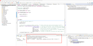

你好,
在调试模式下,按恢复键,然后发送雷达配置cfg 文件。雷达报告错误,在正常模式下发送配置参数,一切正常。这是什么原因呢?
Hello.
You may need to reset the device before re-entering debug mode. Try power cycling the device or disconnecting from the core, pressing NRST, and reconnecting, resetting, and reloading the code.
Sincerely,
Santosh
HI.
Each time you need to Reset the CPU to enter the debug mode, but the problem is the same as before.
Can you please let us know the specific firmware you are using? It appears you are running mmwave_demo but can you please let us know which version of the SDK?
Also can you let us know the steps you are taking to setup the demo in debug mode before you press the resume key? The procedure is described in this guide. This includes first flashing the board with 'empty.appimage'. Please confirm you are following these steps.
Josh
