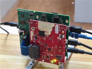

I have a problem with connecting IWR1843&DCA1000 and mmwave studio. It still says SPI is disconnected when I have pushed the `SPI connect` button.
below is the log:
[17:44:09] Status: Failed, Error Type: RADAR INTERFACE ERROR
[17:44:14] MSS Power Up async event was not received!
I have checked: S2 switch in SPI mode, SOP[2:0] == 011.
I have tried `format SFLASH` function by using uniflash. But It doesn't work when I turn back to mmwave studio.
Here is entire screenshot:
If you need more information, please notify me.

    Now I am not sure whether DCA1000 has broken down or not. Can you help me to check the Fig.3 ?

    Without the four DevPack ports showing up, you are unable to do anything such as reflashing the DCA1000's FPGA. The two COM ports 24 and 25 are the mmWave Sensor. Your Fig 3 is perfectly normal. Can you try removing the SD card if there is one connected? Although this typically does not prevent the DevPacks from showing up. If the FTDI driver does not work, and you have tried on another computer and still do not see the four DevPack ports, and have tried different cables, then there is not anything else you can do. Ethernet will have no change on exclusively the four DevPack ports showing up, only the USB cable connected to the "RADAR_FTDI" slot, but Ethernet not showing a connection is a further sign of an issue. I believe there is a hardware issue here, so please reach out to customer service and feel free to refer to this thread as evidence of a malfunctioning board. We are sorry for the inconvenience.

    Yes, neither of them don't display the four DevPack ports. On the second computer, I can see both two COM ports and two unknown USB devices. But their appearance is related to whether the iwr1843‘s cable is connected or not. So, is it confirmed that there is a malfunction with the DCA1000?
    If you cannot get the four DevPack ports to show up, then unfortunately there is not really any more debug steps you can take. FTDI drivers, changing USB cables, ensuring 5V 3A power supply being used. The four ports should show up independently of the mmWave sensor's presence. I imagine nothing shows up under "Unknown Device" either in Device Manager? If so then I can confirm there is an issue with your DCA1000, please reach out to customer service and feel free to refer to this thread as confirmation of your issue. We are sorry for the inconvenience.
