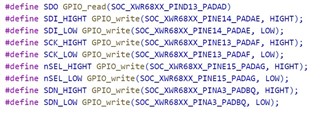

After we multiplexed the SPI pins into GPIOs when designing the IWR6843AOP, we found that the level could not be flipped and was always in high.
1) Pin multiplexing, which multiplexes SPI pins as normal GPIOs
2) Pin configuration, configured for output mode
3) Pin High-Low Level Flip
So we are wondering is there a limit to pin multiplexing, or is there any mistake with using it this way? Can you help to confirm it?

    If you look at the datasheet, you can see that you can use the SPIA pins as GPIO with no problem.
    Are you bit-banging SPI? It looks like a maybe based on those functions composed in the bottom image. If you are bit-banging, you should NOT be setting up or initializing the SPI driver in anyway. If you are attempting to use all 4 SPI pins as GPIO and you have also initialized the SPI driver, you will run into a problem where the SPI-state machine will not allow it (since SPI needs at least the CLK, a data line, and CS). You can see this in the TRM for SDK3 under SPI > "Using Unused SPI Pins as GPIO".
    If you are using the SPI driver and you want to use an unused data line as GPIO, you have to register with the SPI controller that you are wanting to use that line as GPIO in software.
    See this function implementation below which sets MOSI line to GPIO.
    // Tell the SPI driver MOSI will be GPIO
    ptrMibSpiReg->SPIPC0 = CSL_FINSR(ptrMibSpiReg->SPIPC0, SPIPC0_SIMOFUN_BIT_END, SPIPC0_SIMOFUN_BIT_START, 0U);
    ptrMibSpiReg->SPIPC0 = CSL_FINSR(ptrMibSpiReg->SPIPC0, SPIPC0_SIMOFUN0_BIT_END, SPIPC0_SIMOFUN0_BIT_START, 0U);
    // Set up pinmux for MOSI line as GPIO
    Pinmux_Set_OverrideCtrl(SOC_XWR68XX_PIND13_PADAD, PINMUX_OUTEN_RETAIN_HW_CTRL, PINMUX_INPEN_RETAIN_HW_CTRL);
    Pinmux_Set_FuncSel(SOC_XWR68XX_PIND13_PADAD, SOC_XWR68XX_PIND13_PADAD_GPIO_19);
    // Set the GPIO to be output
    GPIO_setConfig(SOC_XWR68XX_GPIO_19, GPIO_CFG_OUTPUT);
    GPIO_write(SOC_XWR68XX_GPIO_19, 0);
