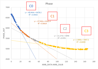

  • It is an additional question.
    The data sheet says:
    The ambient coefficient scaling factor SCALE_AMB_PHASE_CORR_COEFF should be selected such that all the coefficient values fit within 8-bit signed number (–128 to 127)
    However, we ended up with a value of "coefficent" less than -128. Please tell me how to deal with this.
    I calculated the separation slope as shown in the image.
    After that the coefficent is -161.856
    Slope=-40.464
    coefficent=slope * 2^(2 + scale) = -40.464 * 2^(2 + 0) =-161.856
    Do I have to take physical measures such as changing the lens?
  • Hi Mahiro,
    What are the coefficient values if you select different values for SCALE_AMB_PHASE_CORR_COEFF?
    Thank you,
    Brent Elliott
