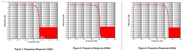

    I think we can estimate the resolution with some of simple calculations based on some data sheet plots.
    Figure 7-9 in the data sheet show the bandwidth and dynamic range of the device for Fsamp = 100Hz, 200Hz, and 400Hz.
    Based on the plots, we can approximate the  dynamic range as:
    Fsamp (Hz) Dynamic
    Range (dB)
    100 98
    200 100
    400 103
    If we assume the traditional 6dB/bit, then we can approximate the resolution as:
    Fsamp (Hz) Resolution (bits)
    100 ~16.3
    200 ~16.7
    400 ~17.2
    where we round of bits to nearest integer for reporting purposes.
