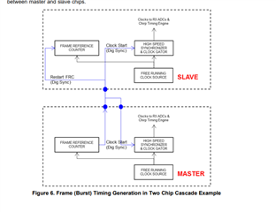

    I was thinking that there would be an SMA connector or something similar where the dig sync could be accessed on the host board, but I just checked the schematic and that does not seem to be the case. The dig sync is connected directly to the TDA processor, so using studio with hw trigger will not be possible unless you solder a wire to bring the dig sync out to a signal generator.
    The FRC is used to maintain the timing across frames, so this error typically would indicate that there is some kind of issue with your external digital sync trigger timing.
    https://www.ti.com/lit/an/swra574b/swra574b.pdf
    Is it possible that your sync in pulse is sometimes below 25ns? Can you increase it to 30ns or so to add some margin? Also, is your hardware trigger timing meeting the requirements in note 4 below?
