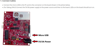

  • Hi Josh,
    So I was trying to run a mmwdemo from CCS. So the pin configuration to be used is functional mode as you told. But do we need to connect the power 5V/3A supply as shown in the figure?
    For running the demo in CCS functional mode is correct but you must have the 'empty.appimage' flashed on the board. Please see the guide I linked in my previous reply which describes this process.
    No, this should not be required. Most PCs should output enough power over USB so an additional power supply is not required. Are you experiencing any issues which you think may be related to insufficient power or are you just looking for confirmation?

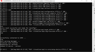

  • Hi Josh,
    As mentioned I was following the steps till 3.3 and opened visualiser for sending configuration. Then Iam getting this message.
    In visualiser.
    When I started the project build I have already done the reset and power cycling.
    Can you please guide what sould be the next step?
    If I reset the board manually iam getting this on CCS
    Cortex_M4_0: JTAG Communication Error: (Error -1170 @ 0x0) Unable to access the DAP. Reset the device, and retry the operation. If error persists, confirm configuration, power-cycle the board, and/or try more reliable JTAG settings (e.g. lower TCLK). (Emulation package 9.10.0.00080)
    visualiser not showing anything rather than this

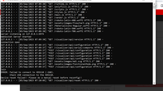

  • Later I tried like before sending config through visualiser I manually resettted the device by pressing NRSTbutton and send the config file
    then iam getting like this
    and same JTAG communication error in CCS

    Okay so the issue occurs with both visualizers when running the demo while connected in CCS and .out file is loaded. I am checking this on my end and will update you here by the end of the day.
    Josh
    Very sorry for the delay here. I am still investigating this issue. Please allow me some additional time to find a solution. I will respond here Monday of next week. Your patience is greatly appreciated.
    Josh
    Thank you very much for your patience. I have been able to reproduce the issue that you are seeing when you try this with the SDK Visualizer (Low_power_visualizer_5.3.0.0). I have reported the bug to our software team to try to identify a fix.
    I have however been successful when using the Industrial Visualizer (from Radar Toolbox) as mentioned above. Please follow this guide (Using CCS Debug) to set up the demo in CCS. After completing section 3.3 then follow the steps in the Presence and Motion Detection User Guide (Starting from the section 4. Open the Radar Toolbox Industrial Visualizer ) to send the config.
