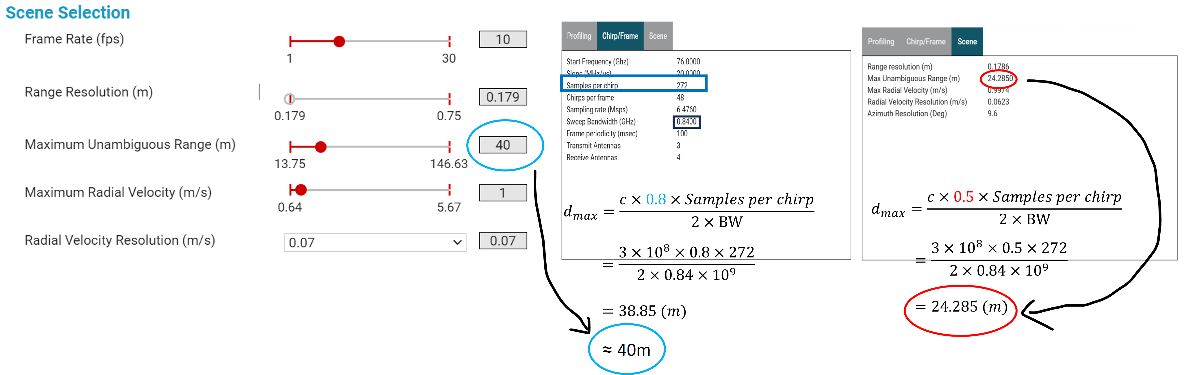

Hi TI experts,
With using mmWave Demo Visualizer, I adjusted the slider of the max unambiguous range to 40m in "Scene Selection", but the max unambiguous range was 24.285m in the "Scene" window. Please see the picture below.
Question 1: Why they are not coherent?
Question 2: According to this thread below, I have learned 0.8 of a safety factor which was used to account for the Nyquist limit. However, I have no idea why 0.5 of a safety factor is considered in the "Scene" window. Could you help me to clarify it?
(e2e.ti.com/.../iwr6843-max-unambiguous-range-displayed-in-mmwave-demovisualizer
