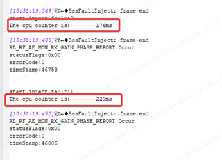

In fact, when I configure the wave period to be 40ms (framePeriodicity=(40000000U / 5)), I inject a RX0 fault of RX_GAIN_DROP as shown in the figure below, and through log printing, it is found that the actual consumption is about 53ms. (229ms-176ms=53ms)
《mmWave Radar Interface Control Document Revision 3.30》
[10:31:19.349]收←◆BssFaultInject: frame end
start inject fault:0
The cpu counter is: 176ms
[10:31:19.400]收←◆BssFaultInject: frame end
RL_RF_AE_MON_RX_GAIN_PHASE_REPORT Occur
statusFlags:0x00
errorCode:0
timeStamp:46753
start inject fault:1
The cpu counter is: 229ms
[10:31:19.452]收←◆BssFaultInject: frame end
statusFlags:0x00
errorCode:0
timeStamp:46806
Why is there such a big difference between the measured time and the 《AWR294x Safety Manual Functional v0.601》 time in the document? How can I achieve such a small time as stated in the documentation (about 1ms)?

    The fault injection API is to be issued when no frames are ongoing. The corresponding monitor for which the fault is injected should be enabled. I assume you have done these 2 steps correctly.
    Now the issue is when you issue the fault injection API that is not the exact time when the fault is injected. The fault will be injected only at the time of framing. So your measurement is not accurate in the code.
     Also remember the monitoring happens in the frame idle time only. So the detection of fault will happen in the monitoring duration only.
    The total error time is also HW plus SW time (Mbox reporting time). So, you have to take that into account as well.
    Typical test execution time is written as 1 ms and it also mentions that this depends on user programming. So, you can reduce your frame duration and remove any irrelevant calls to the BSS to further optimize your code.
