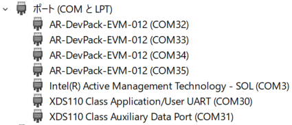

RS232 cannot be connected in mmWave Studio 3.1.1.
"Error: Connection failed: Calling_ConnectTarget returned 3"
Attached is the log in the output window.

[14:44:09]  [RadarAPI]: ar1.Connect(30,921600,1000)
[14:44:12]  [RadarAPI]: Error: Connection failed: Calling_ConnectTarget returned 3

  • Hi Daisuke-San,
    You are using the XDS COM port for the connection. As per the screen shot shared by you need to use port 35 and baud rate of 11520. You need to use one of the FTDI ports for RS232 connection. One of these 4 COM ports will be able to connect to the device. If one does not work, you can try with the other remaining ports until one connects.
    Pradipta.
