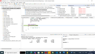

  • Hey TIm
    I tried to memcpy the contents in outParmsCfar.rangeProfile still the same situation is happening the program is waiting in while loop as shown below while I paused the execution,
    My need is just to access the values in outParmsCfar.rangeProfile and convert it from uint32_t to float and use this value for a classification function.
    You can see the debug window also they are showing some ISR handlers right. When I checked this outParmsCfar.rangeProfile it is in L3 RAM and why it is not able to access the values inside it for a local variable. ???
    Sreekesh Giri
  • Hi Tim,
    My issue got resolved.
    volatile uint32_t gDebugTargetCode = 0;
    by changing  the above variable to one like shown below.
    volatile uint32_t gDebugTargetCode = 1;
    in mmwave_demo. There is a description of the variable as
    /* In order to debug target code (set brake points, step over,...) set this variable below to 1 in CCS
    * expression window. It will prevent ISR mmwDemoFrameStartISR from forcing the code to stop */.
    Tim.
