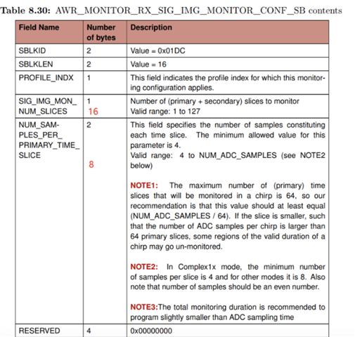

We have configured the CQ1 register of AWR2243 as follows

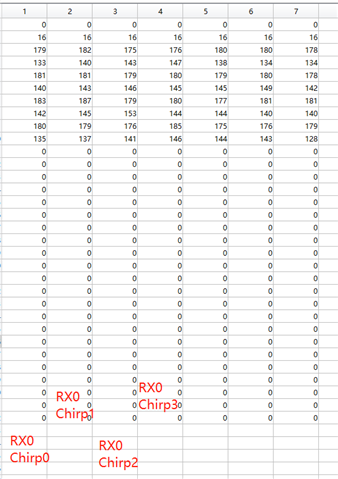

Then we observed the CQ1 data output as follows:
The problem is as follows
1. Why did I set 16 slices, but only 8 valid data outputs were missing? (Note: The first two zeros and 16 are information for 0 and N)

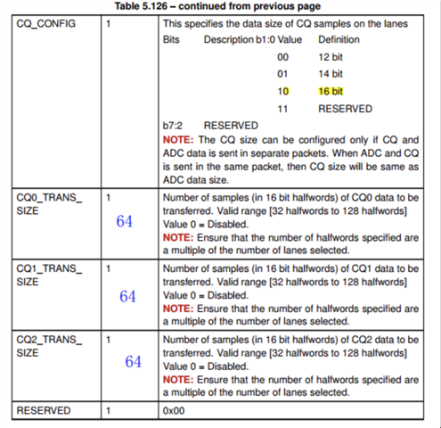

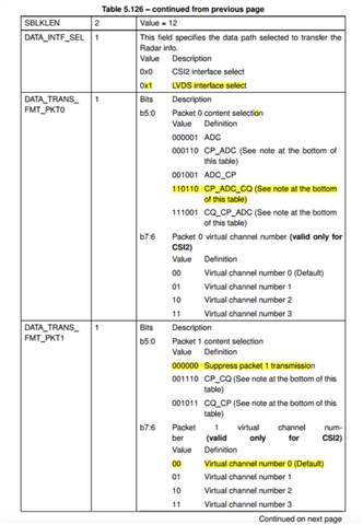

2. How can I calculate the signal power back from the above data? My CQ configuration is 16bit, and the entire data format configuration is as follows:

    RxSigImgMonCfg.profileIndx = 0;
    RxSigImgMonCfg.numSlices = 16;
    RxSigImgMonCfg.timeSliceNumSamples = 8;
    retVal = rlRfRxSigImgMonConfig(deviceMap, &RxSigImgMonCfg);
