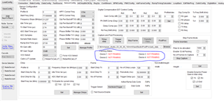

Hi:

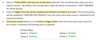

use mmWave Studio 3.0.0.14 to capture raw data by TDA2 EVM and MMWCAS-RF-EVM.
refer to mmwave_studio_cascade_user_guide.pdf.
And the Framing status is NOT FRAMING
And the output is:
[18:50:27] [DeviceId-1] Frame start async event received!
[18:50:28] CAPTURE_RESPONSE_NETWORK_ERROR Async event recieved! Connection error! Please reboot the TDA board
[18:50:28] [RadarAPI]: ar1.RemoveDevice(2)
[18:50:28] [RadarAPI]: Status: Passed
[18:50:28] [RadarAPI]: ar1.PowerOff_mult()
[18:50:29] [RadarAPI]: ar1.FullReset(1)
[18:50:29] [RadarAPI]: Status: Passed
[18:50:29] [RadarAPI]: ar1.SOPControl_mult(1,4)
[18:50:29] TDA Capture Card Status : DISCONNECTED!
[18:50:36] Create Application Response from Capture Card timed out!!
[18:50:44] [RadarAPI]: ar1.StartFrame_mult(1)
[18:50:44] Status: Failed, Error Type: INVALID INPUT

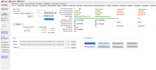

[18:41:42]  [RadarAPI]: ar1.DownloadBSSFw_mult(1,"C:\\ti\\mmwave_studio_03_00_00_14\\rf_eval_firmware\\AWR2243_ES1_1\\radarss\\xwr22xx_radarss.bin")
[18:41:42]  [RadarAPI]: ar1.DownloadBssFwOvSPI_mult(1, C:\\ti\\mmwave_studio_03_00_00_14\\rf_eval_firmware\\AWR2243_ES1_1\\radarss\\xwr22xx_radarss.bin)
[18:41:43]  [RadarAPI]: Error: Download FW failed with error 64
[18:41:43]  Not able to connect with the TDA board. Please check whether the Capture Card is connected to the network!
[18:41:47]  [RadarAPI]: ar1.DownloadMSSFw_mult(1, "C:\\ti\\mmwave_studio_03_00_00_14\\rf_eval_firmware\\AWR2243_ES1_1\\masterss\\xwr22xx_masterss.bin")
[18:41:47]  [RadarAPI]: ar1.DownloadMssFwOvSPI_mult(1, C:\\ti\\mmwave_studio_03_00_00_14\\rf_eval_firmware\\AWR2243_ES1_1\\masterss\\xwr22xx_masterss.bin)
[18:41:47]  [RadarAPI]: Error: Download FW failed with error 64

[18:42:17]  [RadarAPI]: ar1.DownloadBSSFw_mult(2,"C:\\ti\\mmwave_studio_03_00_00_14\\rf_eval_firmware\\AWR2243_ES1_1\\radarss\\xwr22xx_radarss.bin")
[18:42:17]  [RadarAPI]: ar1.DownloadBssFwOvSPI_mult(2, C:\\ti\\mmwave_studio_03_00_00_14\\rf_eval_firmware\\AWR2243_ES1_1\\radarss\\xwr22xx_radarss.bin)
[18:42:18]  [RadarAPI]: Error: Download FW failed with error 64
[18:42:22]  [RadarAPI]: ar1.DownloadMSSFw_mult(2, "C:\\ti\\mmwave_studio_03_00_00_14\\rf_eval_firmware\\AWR2243_ES1_1\\masterss\\xwr22xx_masterss.bin")
[18:42:22]  [RadarAPI]: ar1.DownloadMssFwOvSPI_mult(2, C:\\ti\\mmwave_studio_03_00_00_14\\rf_eval_firmware\\AWR2243_ES1_1\\masterss\\xwr22xx_masterss.bin)
[18:42:22]  [RadarAPI]: Error: Download FW failed with error 64

[18:49:27]  [RadarAPI]: ar1.FrameConfig_mult(2, 0, 0, 8, 128, 52, 0, 2)
[18:49:27]  [RadarAPI]: Status: Passed
[18:50:25]  [RadarAPI]: ar1.TDACaptureCard_StartRecord_mult(2, 1000, 0, adc_data, 0)
[18:50:25]  Device 0 - Configuring TDA with Width : 4096 and Height : 128
[18:50:25]  [RadarAPI]: Device 0 - setWidthAndHeight Status: Passed
[18:50:25]  Device 1 - Configuring TDA with Width : 4096 and Height : 128
[18:50:25]  [RadarAPI]: Device 1 : CAPTURE_RESPONSE_ACK Async event recieved() with status 0
[18:50:25]  [RadarAPI]: Device 1 - setWidthAndHeight Status: Passed
[18:50:25]  [RadarAPI]: Device 2 : CAPTURE_RESPONSE_ACK Async event recieved() with status 0
[18:50:25]  Device 2 - Configuring TDA with Width : 0 and Height : 0
[18:50:25]  [RadarAPI]: Device 2 - setWidthAndHeight Status: Passed
[18:50:25]  Device 3 - Configuring TDA with Width : 0 and Height : 0
[18:50:25]  [RadarAPI]: Device 3 - setWidthAndHeight Status: Passed
[18:50:25]  Sending Frame Periodicity of 52 to TDA..
[18:50:25]  [RadarAPI]: Status: Passed. Frame Periodicity sent to TDA
[18:50:25]  [RadarAPI]: Device 32 : CAPTURE_RESPONSE_ACK Async event recieved() with status 0
[18:50:25]  Sending Capture Directory with name /mnt/ssd/adc_data to TDA..
[18:50:25]  [RadarAPI]: Status: Passed. Capture Directory sent to TDA
[18:50:25]  Sending File Allocation of 1000 files to TDA..
[18:50:25]  [RadarAPI]: Status: Passed. File Allocation sent to TDA
[18:50:25]  Sending Enable Data Packaging (0 - 16-bit; 1 - 12-bit) with value of 0 to TDA..
[18:50:25]  [RadarAPI]: Status: Passed. Enable Data Packaging sent to TDA
[18:50:25]  Sending Number of frames to capture with value of 0 to TDA..
[18:50:25]  [RadarAPI]: Status: Passed. Number of frames to capture sent to TDA
[18:50:26]  [RadarAPI]: Status: Passed for notifying TDA about Creating Application
[18:50:27]  [RadarAPI]: ar1.StartFrame_mult(2)
[18:50:27]  [RadarAPI]: Status: Passed
