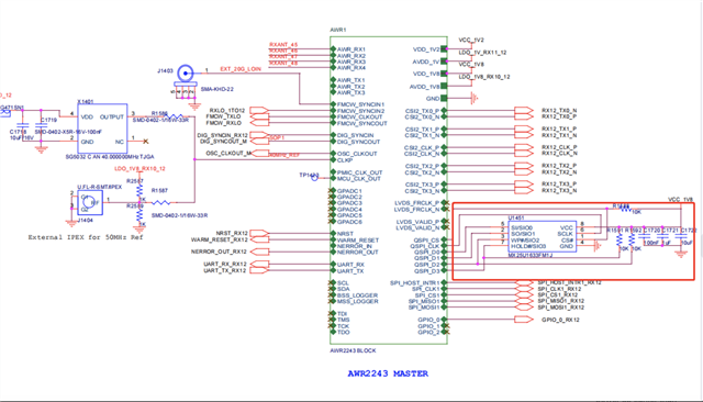

    Hello, I used the xwr22xx_metaImage.h file to download, and no CPU Fault error was reported. I compared the .bin file and found that the .bin file has 4 more bytes at the end. Are these 4 bytes the check code? In addition, I did not receive the MSS_BOOTERRSTATUS event in the red box on the left after downloading. Our AWR2243 is connected to a piece of Flash through QSPI. Is it because of this that the MSS_BOOTERRSTATUS event is not generated? How should I tell if my firmware loading was successful?

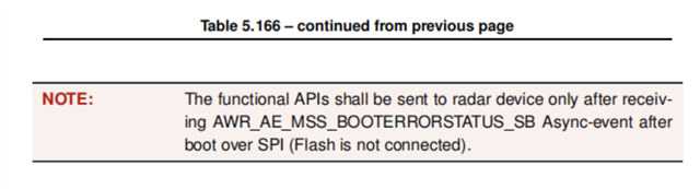

    You should receive the async event.

    I have followed the official routine steps for configuration. Additionally, I would like to confirm that we have an external Flash through QSPI. From both the chip manual and API application manual, it can be seen that this MSS will only be generated if the Flash is not connected_ BOOTERRSTATUS event. Are you sure to receive this event after successfully downloading the firmware? The version number I read on AWR2243 is ES1.1: '2.2.1.7'

  • Hi Gary,
    Yes, in any case you should receive the async event. The Note only describes our test case where we boot over SPI and external flash is not connected. Hence even if the flash is connected the async event should be received.
