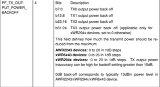

Question 2: According to the "MMWAVE SDK User Guide", one command in profileCFG is as below picture. I would like to know if I am not allowed to change another value to change TX power when I am running over the mmWave Demo Visualizer. Per my experiments, the radiated Tx power didn't have any change when modifying this value.

    2. This is the Tx out power back off config which is used to maintain amplifier's output linearity. More details are there in the image below. May I know how you are measuring the out power?
    3. If you are talking about the <txOutPower>, it is already enabled in the demo when you configure the profile.

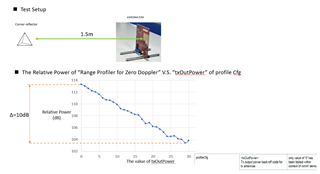

    Here is my setup to measure TX output power.

    I have retested and found the tx power could back off while increasing the value of <txOutPower>. Here is my test setup and test result. I could have 10dB power back off with txOutPower set to 30. Do you think my measurement is correct?

  • I will need to understand the power loss for the distance, but on a higher level, your measurement set up looks correct
  • Hi E. Shareef,
    Thank you for the confirmation of my measurement setup. Based on my measurement setup, I am afraid that the power loss for the distance could not be measured.
    Regarding the plot of the "range profile for zero Doppler", what is the "relative power" on Y-axle? What is it relative to? How do I know the absolutive power (dBm) then?
    Sean
  • The freespace path loss would account to 79.72dB at 77GHz for the signal to transmit and come back from the corner reflector. You should try and enable only one TX and one RX if you are trying to calculate the Output power.

    The relative power I mentioned is as I circled in the below picture.
    This power is computed based on the value of the ADC samples. I think the terminology "relative power" is used because this is not the "absolute power"

    For example, the Relative Power is read as 120 in the picture. Does "120" here stand for 0x078 with a 12-bit ADC mode?
    If I am using 12bit ADC mode, a value of 0x7FF corresponds to a positive peak value at the ADC input, which corresponds to 1V peak voltage at the ADC input. Thus, 0x078 of ADC means a 0.058V at ADC input which is around -15dBm power based on a 50ohm system. Then, -45dBm is the power at the LNA input if the gain of LNA is set to 30dB.  Are there any mistakes with my inference?
    Sean
    Please give us some time to review this with extended team.
    Will get back to you next week
    thank you
    Cesar
    I was able to get an answer earlier than expected.
    Your computation is correct if the scaling of the ADC data is 1.
