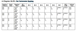

Hi Sir,
may we know how the register table is converted into RPM value?
because the datssheet no label formula or calculation method.
Hi Sir,

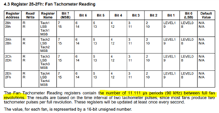

Hi Tommy,
The formula is RPM = (90,000 * 60) / register.
