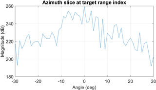

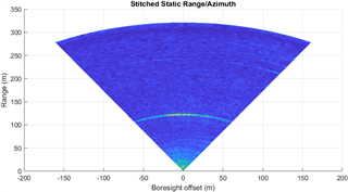

Hello.
The reference design document shows that the beamforming capture, in an anechoic chamber after calibration, has lower sidelobes than that which can be seen in my capture. I performed calibration indoors and obtained a decent calibration LUT, however this was not performed in an anechoic chamber. Is this the reason for the sidelobes?
My calibration matrix:
My results:
The scene:
The expected result from the reference design (right figure):

    • It is always suggested that you perform calibration in an anechoic chamber for best results.
    • From your calibration matrix, I can't make out much. This can differ quite a bit from chip to chip and from one calibration environment to another.
    • For your heatmap comparison, would it be possible to depict in the same fashion as done in the reference guide? This can help visualize the error to a better degree.
    • Looking at your scene and second plot, it does look like there might be a slight deviation that could be caused by calibration. Would suggest you perform the same test inside a room while facing a flat wall of uniform surface once if possible.

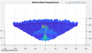

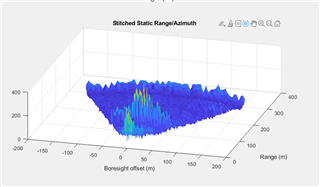

  • I am quite certain the error is due to imperfect calibration, since the reflector was not positioned exactly in line with board center and calibration was performed in a relatively small room. Here is the 3D plot/s as requested. I notice a raised level at the furthest range at all angles. Do you have an idea of what this could be?

    We managed to acquire additional office space with access to a large, open room. Both the RX and PS calibration results are looking better. I will continue testing with the improved calibration matrices and update this thread as needed. So far, the latest RX calibration has drastically improved the angular resolution of the platform.
